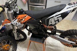

2 Stroke Picked up a bargain SX50 today :)
As title says.. Absolute bargain today!
Went to view a 2012 KTM SX50, with small and big wheels set...
Viewed it, all good.. Seller started it up, and it started spitting out coolant...
A bit annoyed that i had driven 2 hours to view it, potentially for nothing.. I asked him what he'd accept for it, Seeing as it has an issue somewhere...
basically.. I ended up getting the bike.. A set of talon big wheels with brand new Pirelli tyres fitted.... A KTM bike stand.. Box of brand new plastics and a bag of assorted sized sprockets....
All for £500!!! (English Pounds)
Turned out the Right side bottom rad pipe has a small perish from where the jubilee clamps have worn into the rubber....

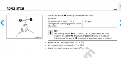

https://www.manualslib.com/manual/1168651/Ktm-50-Sx.html?page=115#manual
Page 114 has adjustment of the clutch. Requires more effort, but seemingly adjustable. Might not do much based on component wear.

Her bike seams to rev quite alot, before the clutch kicks in.. So when it does kick in.. It bursts off like a rocket.. Which is what is scaring her a little...
So the clutch possibly has a 2nd washer added to it?!?!
Because if i am correct.. I want to lower the clutch engagement revs?
So it kicks in sooner, at lower revs.. and hopefully removing the sudden burst of power..

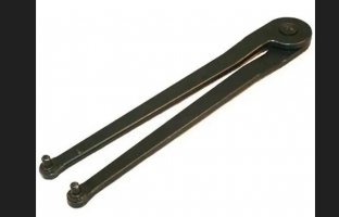

If it doesn't pry out easily like a dust cover...
That could be the head of the bolt and uses a castled wrench?
Sometimes they sell a pin spanner that can be used to removed castled hardware.
