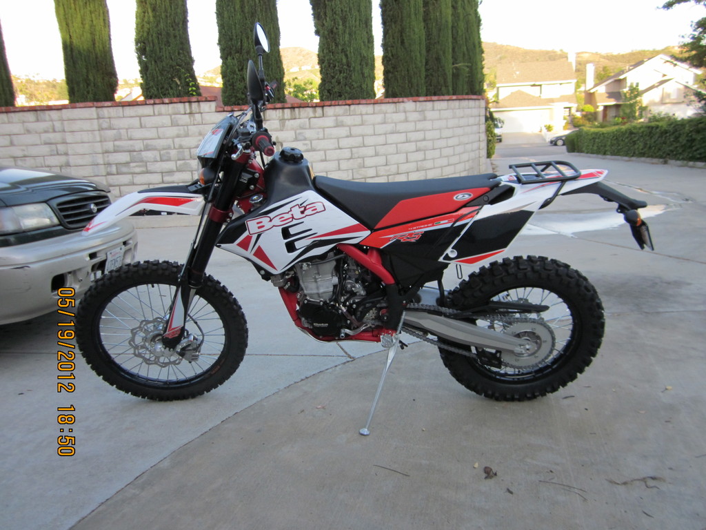

Hey look it's a new bike!
First and likely only brand new bike that I'll ever own. It had better be good. It sure looks nice.

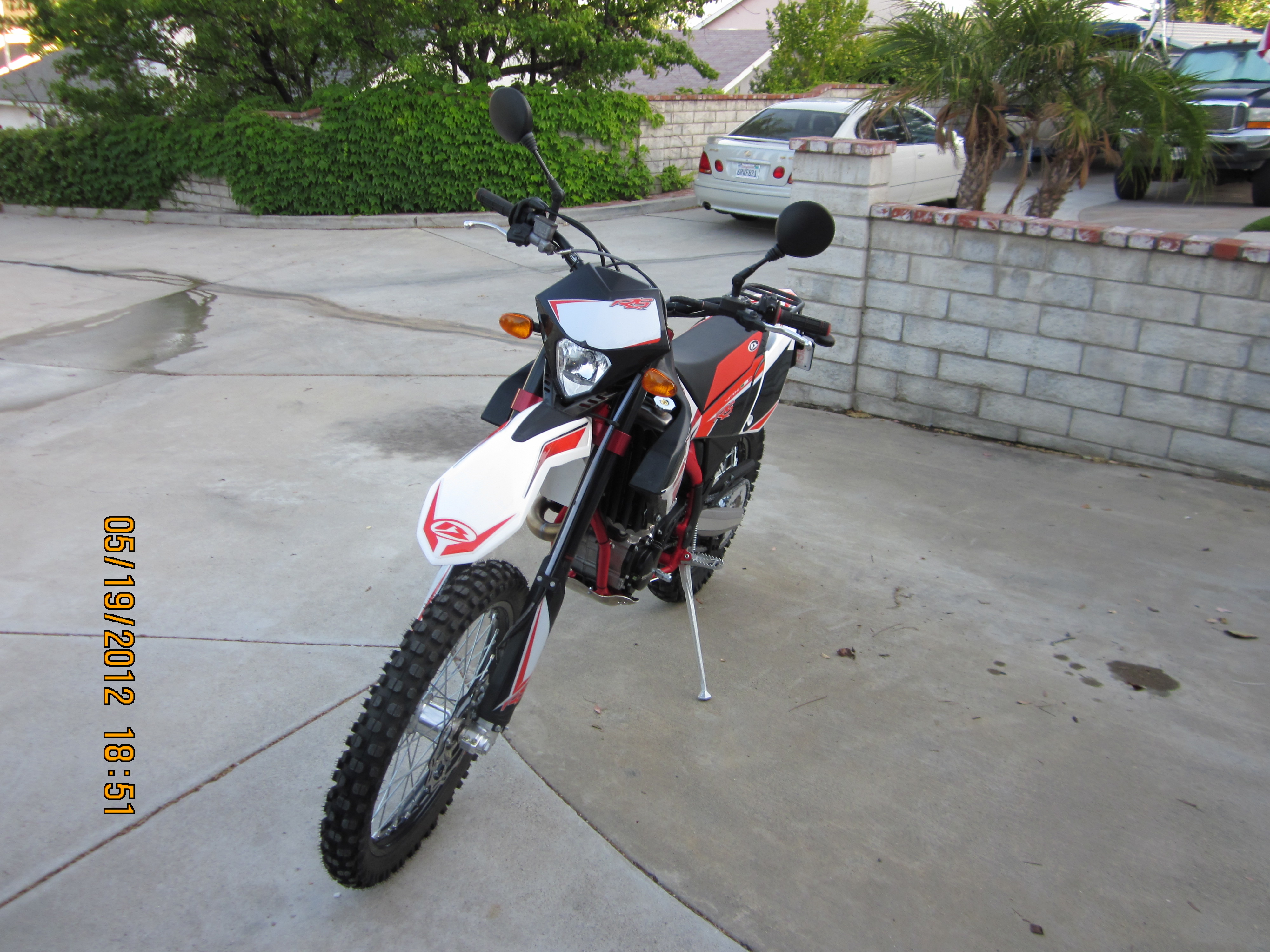

So far I've only done a little putt around the neighborhood for maybe 15 minutes just to get a heat cycle in.
50% power on this bike is about 100% of the XR. At 100% you will be going real fast real quickly.
The bike has a cool little compartment inside the left rear side panel aft of the air filter. The RR has a tool kit there. I think you could get some tools and a tube in there. The RS has a smog component. It looks like it's a charcoal gas vapor capture can. It might get "relocated" a bit so I can use it for a tool kit.
