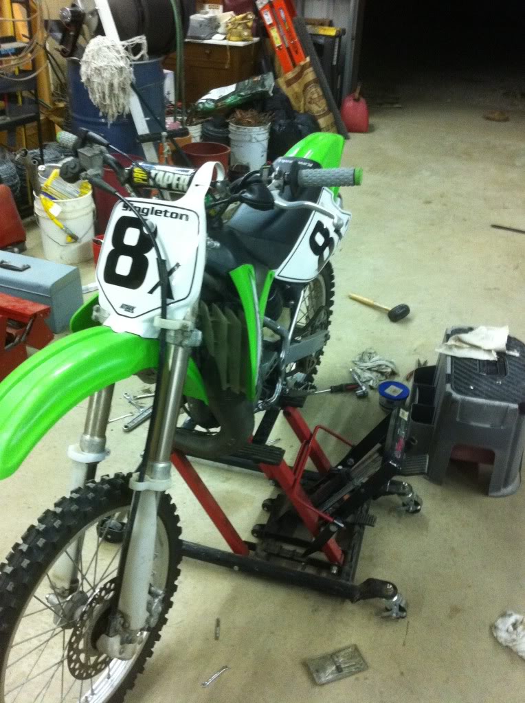

100 04' KX100 Rebuild

I got the pinging down to a minimum, but it still pings about every 15 seconds at idle... The only other way to get the pipe to work CORRECTLY would be to run AV gas which a tennager w/no job can't afford :bonk: So it look as if i'll be putting on the stock kx100 pipe i ordered off of FLEABAY lol. I swear guys why can't a 'rebuild' ever be as simple as it appears. :foul:
All done, the stok pipe fixEd the pinging
