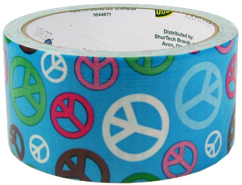

I tape all my brand new rims, not going to see it. Or do what I do and use some sweet looking tape like this:
:smirk:
