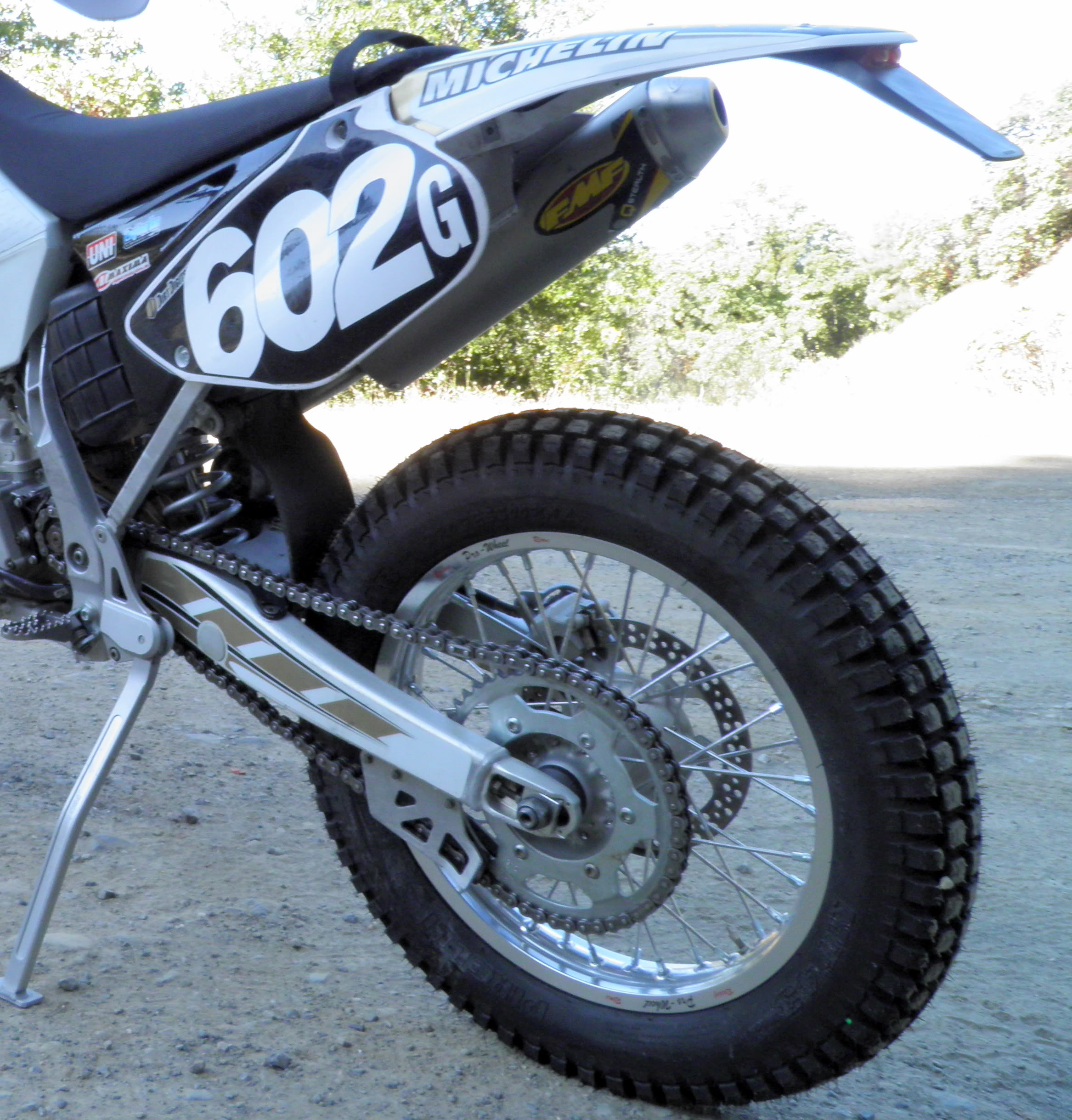

Pirelli Trials Tire for Trails and Dessert racing.
Question, what kinda psi do you guys run front and back, do you run more in he front so you don' ding a rime?
I took a air source and tire gauge and experimented for a few hours. I tried all sorts of pressures. 7 rear 10 front for max traction, maybe 15 in both for any type of road work (I have a plate).
Just to be clear: not many people use a front trials tire, but I do.
I had run the rear before with a front knobby, and just switched to both front and back... about 15 pounds is what I'm running, only because I get a lot of pinch flats... I've heard 8-10 works good; run a HD or ultra HD tube
but I am a pinch flat waiting to happen and string some hiway miles with rocky trails and sand...
I run a Pirelli DOT knobby on the front and the MT43 rear at about 11. No pinch flats so far. Due to the taller sidewall I feel that the pinch resistance is about the same a 11 as a knobby at 14 or 15. The traction is unreal.
Like Timo is saying I wasn't sure I really trusted it in the desert. I still don't know if I trust it 100%, but I'm up to 85% or so. The only way to know it to try one. Some like then and some hate them. Tires are a very subjective area. What works for one might not for another.
