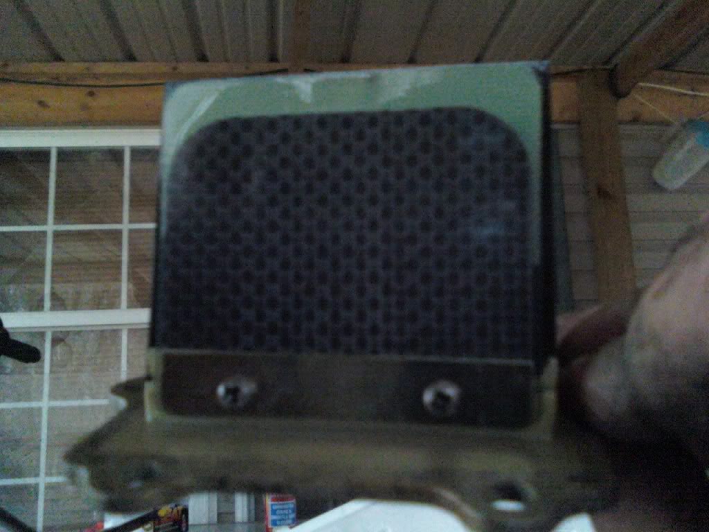

haha... the reeds look like brand new...im guessin there boysen pro reeds... ...i got it tore down now... pondering the idea of should i take the top end off and check it out... or atleast the head...well im about to pass out... ill fill ya more tomorow

still waiting on jets... i confirmed that the throttle needle was on the third notch..and my reeds are in perfect shape from what i can tell.... im thinkin about pulling the head off and checking pistion but im affraid i will find something i dont want...lol
