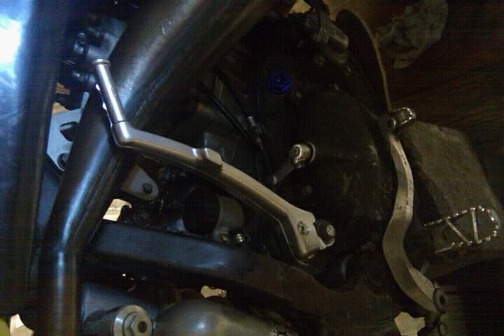

Got a rear MSR rotor gaurd still to put on
Front wheel bearings (Had to order another set and just got them today, I cannot find the last set i ordered)

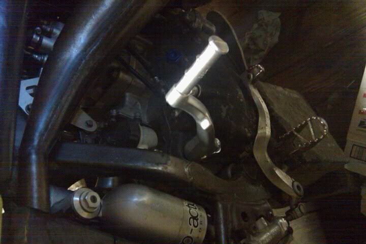

Got a new kick starter waiting to go on
Flywheel weight waiting to go on
reed spacer waiting to go on
Still need to get fork gaurds and side panels but put them off for now
Waiting on fork seals and fluid to get here.
