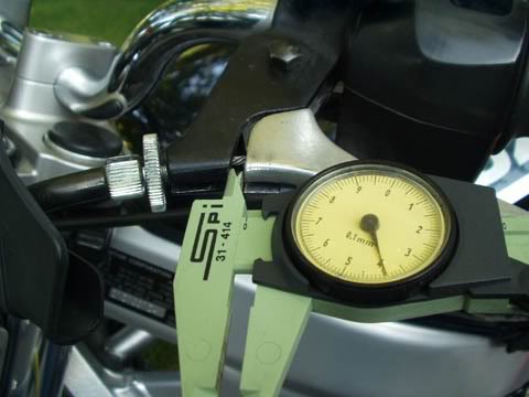

This is where you need to check your space at..
Snowflake said a dimes width... I had always heard 2 quarters stacked... I dont know whose right....:prof: lol

Up and down isn't that big of a deal, just means that the lever's loose in the perch (might be time for a new one). I'd at least check to make sure that the bolt is tight, don't want your lever coming off. :shocked: (I'm referring to that top (black) bolt you see in bobkyle's picture)
