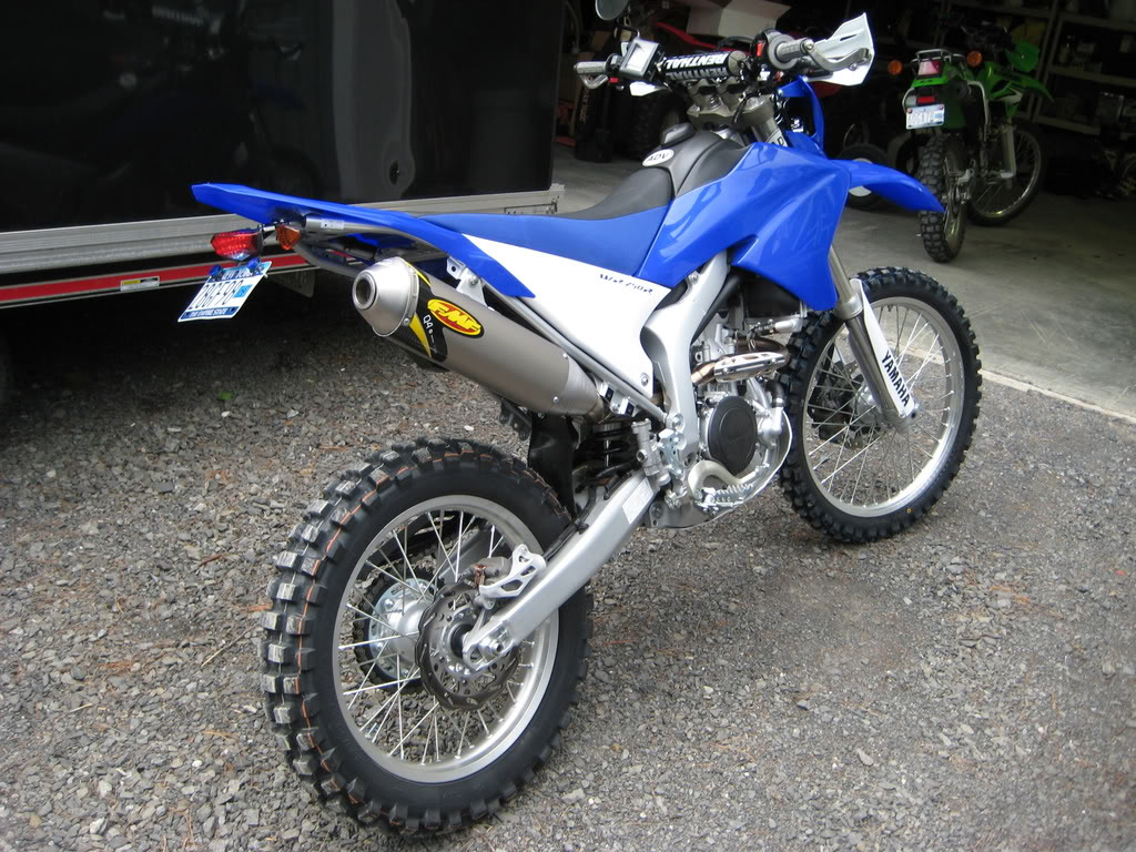

Today, I slapped on new plastics, tail light/license plate assembly, brake reservoir parts, and filled in all the missing body hardware. Later this week, I hope to transfer title and get new license plate, swap out tires/tubes, sprocket, chain, grips, oil, filters and install new ECU (got one cheap on Ebay). Then only thing left to do is locate a used wiring harness for the rear plate assembly and repair ignition. But all in all, the bike currently looks quite presentable with the new parts installed. Will post a pic when it's complete! I wish I would of taken a picture of it before I did work to it, but it was an eye sore to look at:lol: . Should look like this (except for a stock exhaust) in near future :thumb:

My brother and I finished most of the WR. Changed oil, filters, rest of the missing little parts, and most importantly installed the new ECU and soldered and connected the missing wiring harnesses/connectors for the lighting assemblies. I forgot to plug in my spare battery onto a tender so it had no juice. I threw in the Shorai from my bike and cranked over the engine for the first time in a long time. The shorai cranked it to life in less than a second :banana: Still got some work to do (ignition, gearing change once I figure out how low I want to gear it, maybe new triple clamps, some new grips etc) But as of now, it's ready to ride. :ride:
