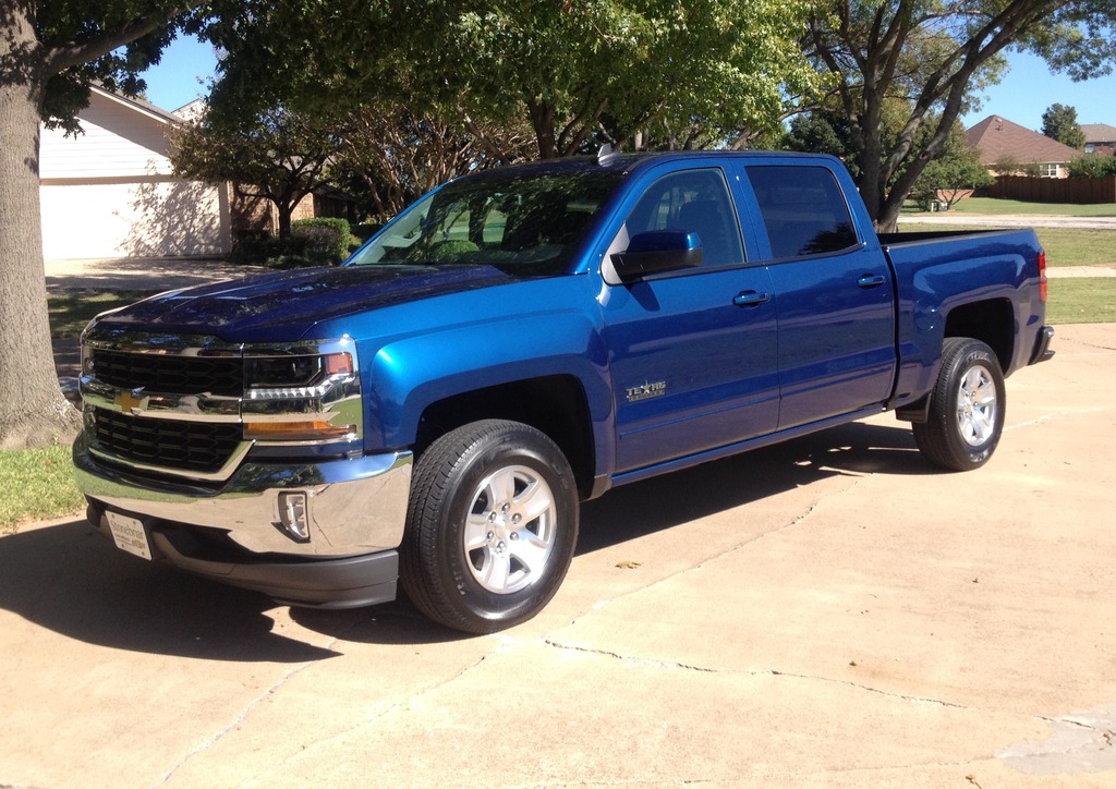

Me? I traded mine in for this one
Sure it's a ladies truck, but the older my bones get, the softer (and more adjustable) my seat needs to be. Besides, it reads me my text messages.
I dig the color.
