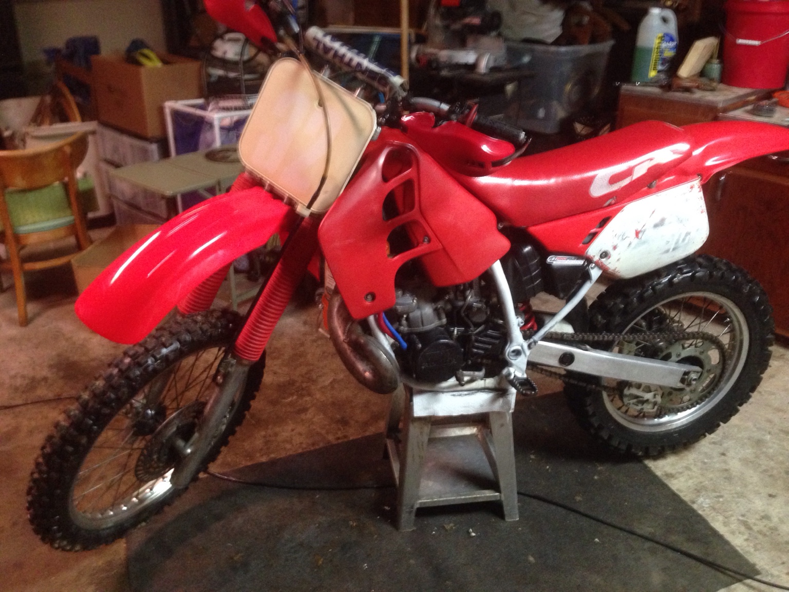

Looking a little better than before

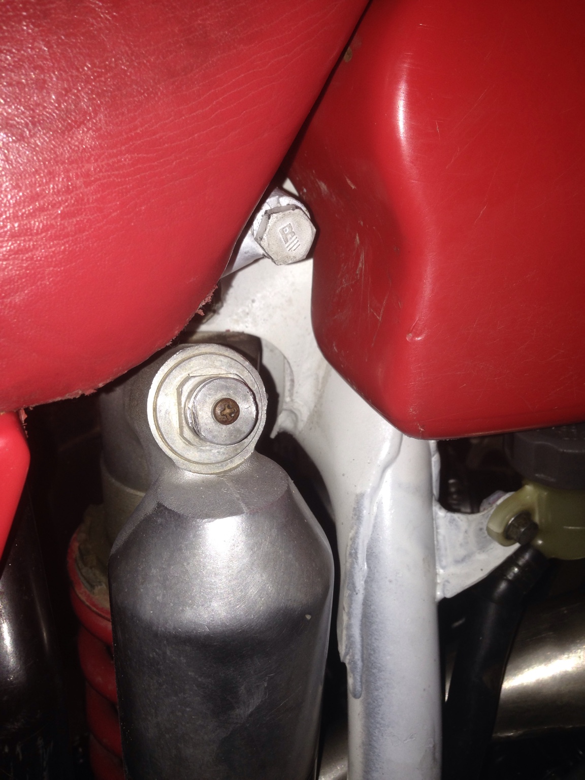

Anyone know what's going on with my missing adjuster knob? Is the really that bad? Will this screw still adjust?

The little adjuster knob is almost always gone, it will still adjust but be careful when trying to turn the screw as brass is easily chewed up so make sure your flat driver is a good snug fit before you go for it! :)
It's a Phillips in there right now. It screws in and out. Doesn't have any clicks or anything?

Ok the Philips screw is not standard and if memory serves me right the click you speak of is caused by a spring mech in the rear of the adjuster knob clicking round on the 2 flat faces at either side of the Phillips screw so the clicks are pretty much just a guide to tell you how many turns or how far you turned it!
Hope this helps
P.s. your reservoir is still available new from Honda or eBay! Not much chance of finding an adjuster knob though :(
It looks like the Phillips screw holds the knob on. I have a shock I can buy with he knob on eBay. I just don't understand how the knob adjusts if it doesn't turn the screw, what does it turn? How hard is it to install? And remember, the 89 shock had the flat head adjuster on it, no knob.
