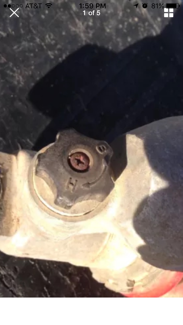

The top bolt is different though. And it looks like if I loctite this screw in, I should be able to adjust my shock. Right now all the screw does, or rather should do is hold on the knob. I still don't understand how the knob adjusts. There is very little for it to grab on to
Sent from my iPhone using Tapatalk
I have never stripped out the rear shock internals and adjuster screw but I gotta think the screw threads into a valve which bottoms and tops out so when you first put the screw in the hole the first few turns are screwing into the valve then next few-couple of turns will be your adjustment and in reverse start turning the screw out the adjustment will topout then next turn will break the lock on the thread and start unscrewing the screw!?!?!?!?
Andy may be able to help here with this as I'm kinda guessing having never had one out! @ossagp Any ideas Andy? Or @SRAD97750 @Mihylo33 @2strokesteve89 :noidea::noidea::noidea:
Currently there is no adjusting taking place. From the way it looks, the screw doesn't adjust. There is a sleeve that the screw threads into, that looks to adjust. So the screw, threads into the adjuster. Missing the knob, it is currently useless. So if I put loctite on, the screw will then turn the adjuster... in theory
Yeah but only if my theory is correct! Before cranking anything you should wait for more replies from other members who have experience splitting shocks!
I honestly don't know. I always just tell ppl to go to Factory Connection and have their boingers set.
I have not the funds for someone else to pump my boinger.... repair I mean. Plus, I like to fidget and learn! Just like the power valves. Had no clue at first, now they work! It'll all come together. It's already come a good ways since I started.
