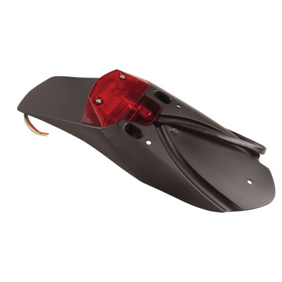

Dan, is there a reason you didn't go with this type of rear light setup? There is no issue with the wires on this as I have been running this on my WR ever since I dual sported it.
This one was $4 shipped from El China. I had it laying around from another project. I don't expect this one to last very long.
That style is what I'll end up with, most likely. -BIG DAN:thumb:
BIGDAN the first thing that goes wrong is the weight on the stock fender... can sometimes fold down on a jump and tear the shit out of everything when the tire catches your screws or wires.
I have tried a half dozen of those tail pieces... this is the best one so far... adds strength to the fender and costs very little.
Made by Polisport... and only $22 at RMATV
http://www.rockymountainatvmc.com/p...-Tail-Light-Brake-Light-Black?term=1420020001
Have a couple of them in the garage... you can check it out next time you are over.
