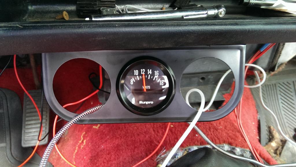

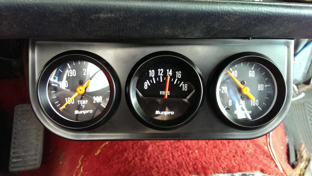

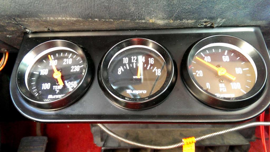

new gauges!
Half installed:
just started the truck:
Fully warmed up(just a hair below 190):

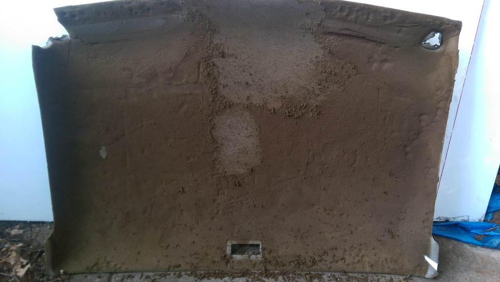

Look at all the nasty old foam that had to be cleaned off.
Got that foam off in about 90 min, completely clean.

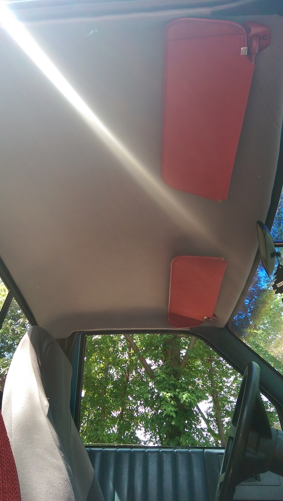

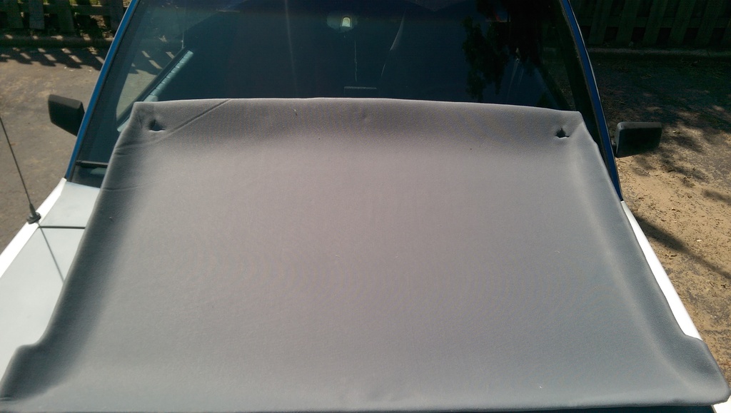

Then came the new head liner material. Not bad for my first time.
Next was hanging it. This took almost a hour to wrestle it up there and keep it up. Easy enough though.
This project took me 3 hours with a trip to lowes in the middle to buy some velcro.

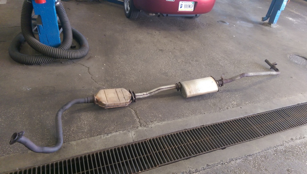

had to take the exhaust off..

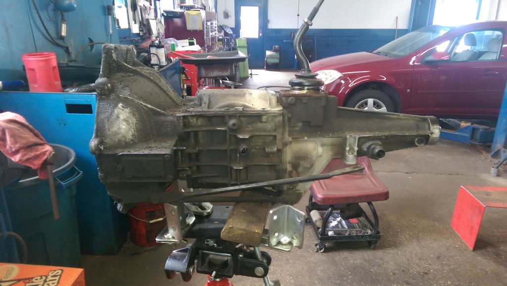

trans is finally out, gross right? my thoughts too...

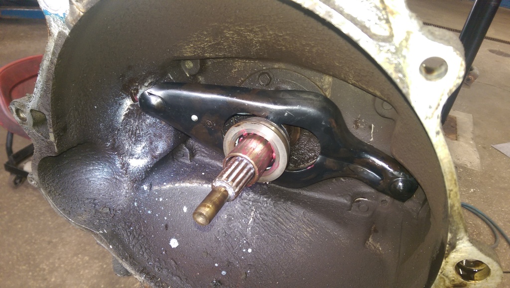

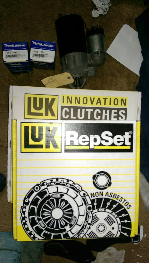

new clutch fork and throw out bearing, still gross

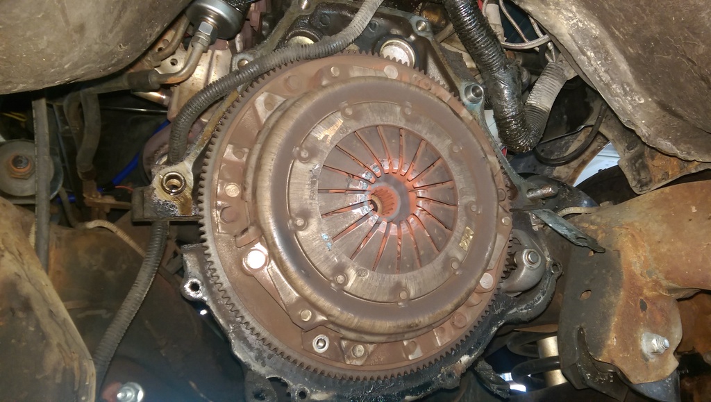

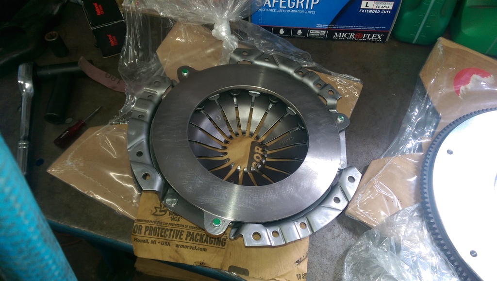

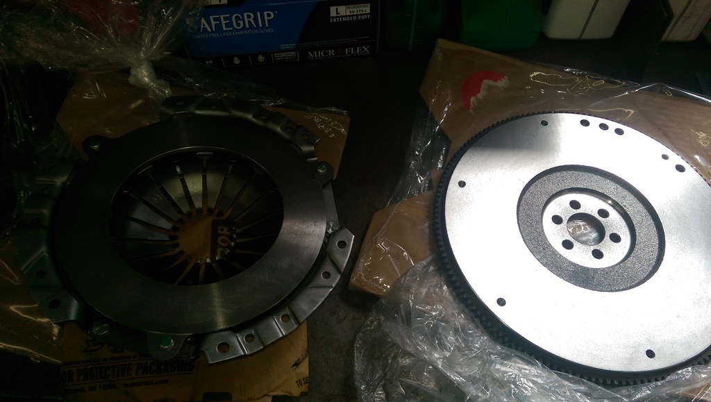

pressure plate and flywheel
pressure plate

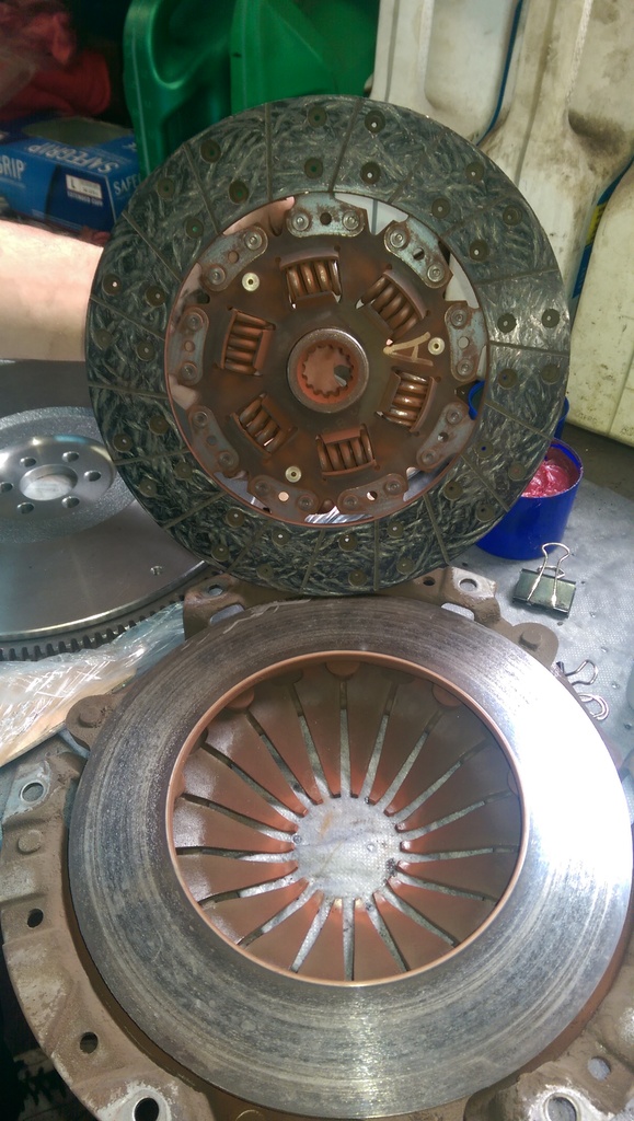

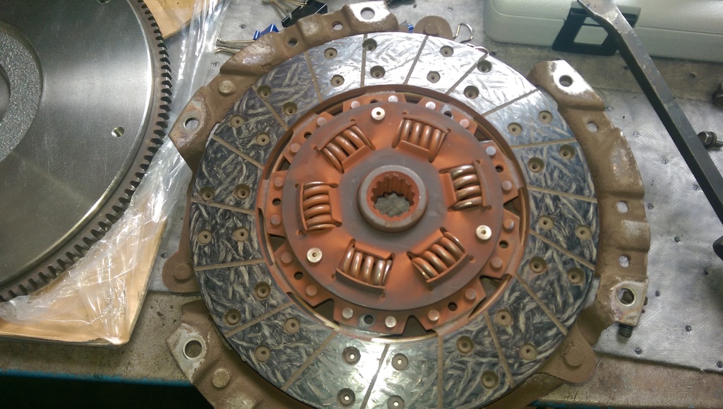

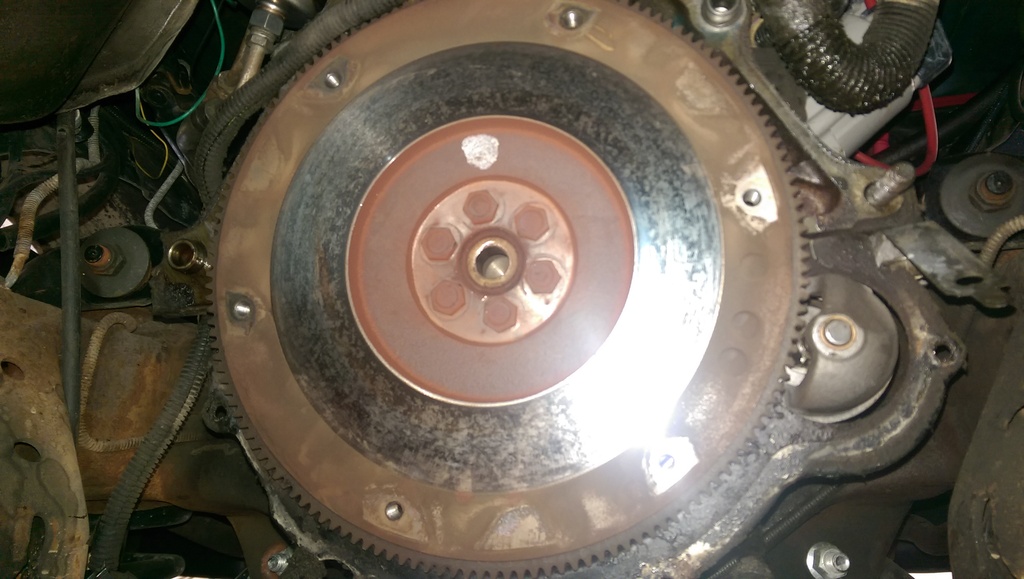

old parts... hmmm witness marks... not good..
old friction disk is looking very shiny... lots of glazing.
Hmm... pressure plate doesnt look hot either.
and neither does the flywheel... good thing I got a new one. there was large amounts of bluing on the pressure plate and flywheel, suggesting prolonged slippage.
