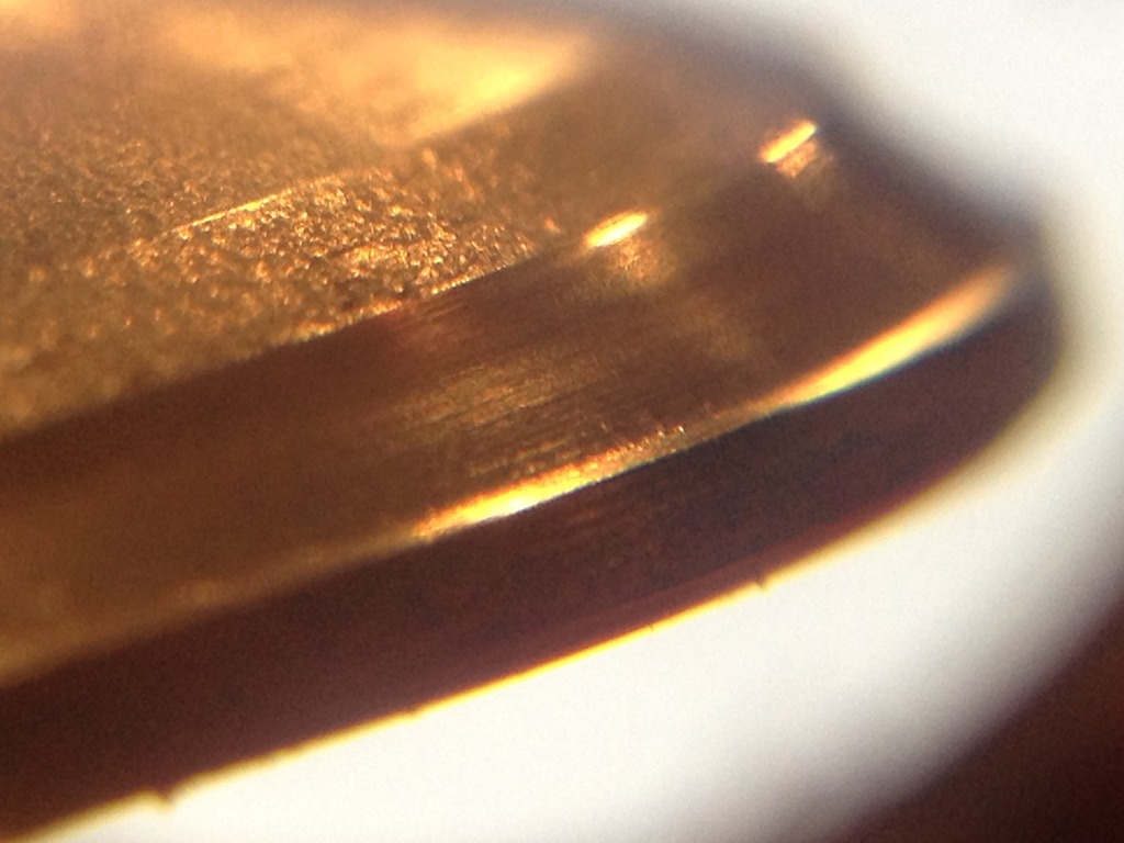

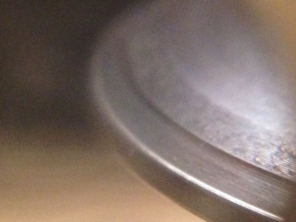

Pulled the piston from the '14 yz250f today.
Cyl looks good piston is a JE 977, no crank slop. Chem dipped and cleaned up pretty good. I was concerned about the zero clearance on the intake valves so I thought I'd hunt down where it went. Gotta figure it had .15mm at some point and I didn't want to just shim and go with it. Pulled the valves and cleaned up sorry no before pics, but here's an after.
have you seen a valve with a dish like this? At first glance I thought it was pounded and there went the .15mm but the closer I looked I didn't see any mushrooming, and the valve margin thickness is right in spec. It just looks very perfect am machined to be a bludgeon effect. Here's another
Anybody seen this on a "good" valve?

Check those seats closely also, most valve clearance issues starts there.

I have found it to be much cheaper in the long run to replace everything as I went through the bike. My theory is why wait for it to go bad if you know its gone its time limit.
Yeah I went ahead and ordered new valves and springs last night. I knew they were shit, I Also knew that's where my clearance went, I just wanted to put it back together. Seats look pretty good but I shut down the anxiety to button it up quickly. Verdict is in though, easiest 4 stroke I've ever worked on.
