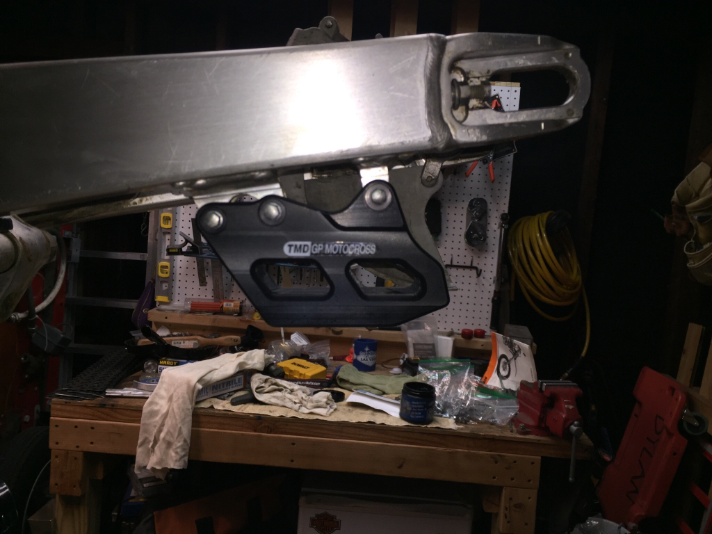

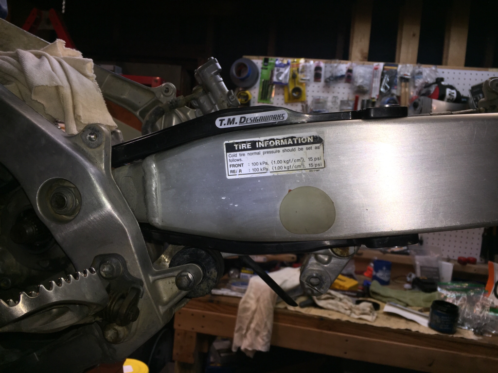

Hey Fellas... I had a productive evening. My first task tonight was to remove the old chain guide and replace it with the TM Design model. Seems like a solid product..

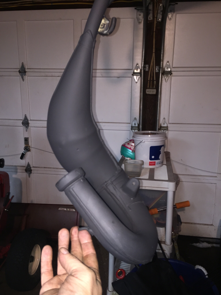

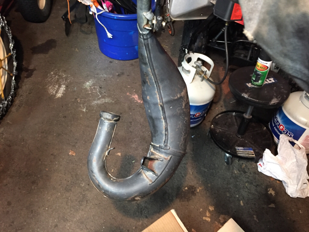

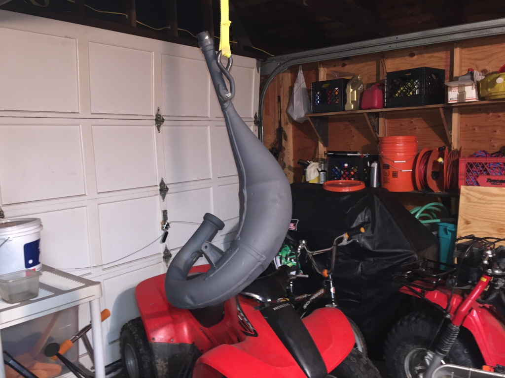

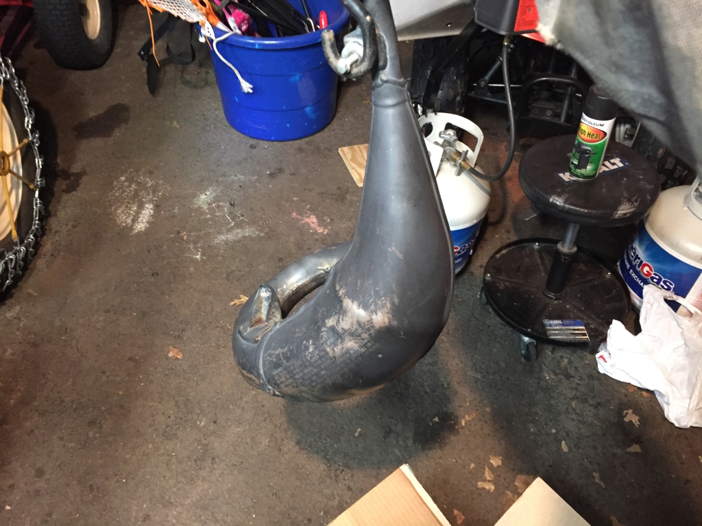

Next I moved on to the pipe. It's a bit dented generally looks shitty so I cleaned all the crap off it, wiped it down with acetone and painted it flat black high heat grill paint.

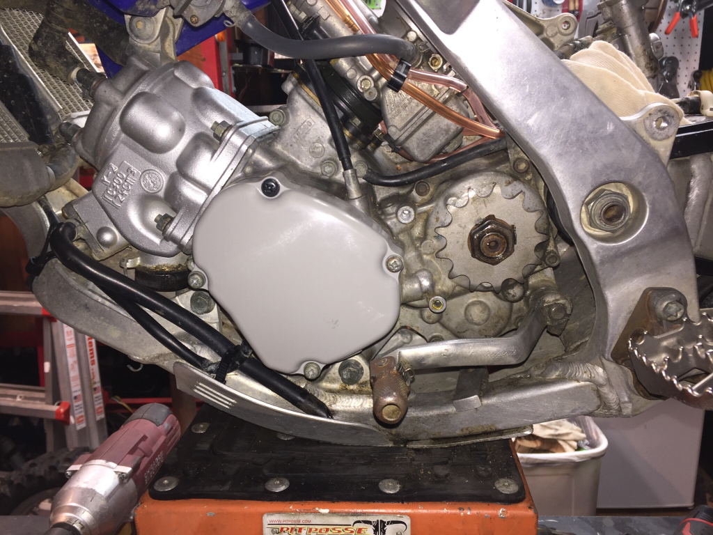

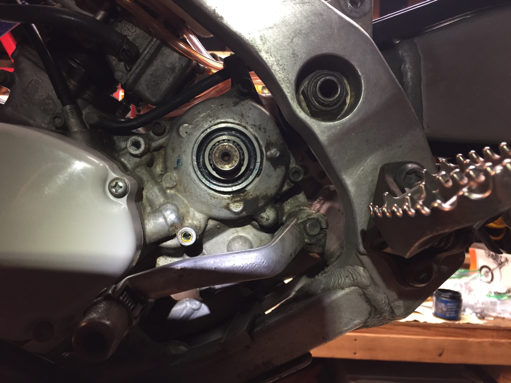

Next I moved onto the new flywheel cover and gasket. Then I did the counter shaft/drive axle seal and collar. Then I installed the front sprocket.

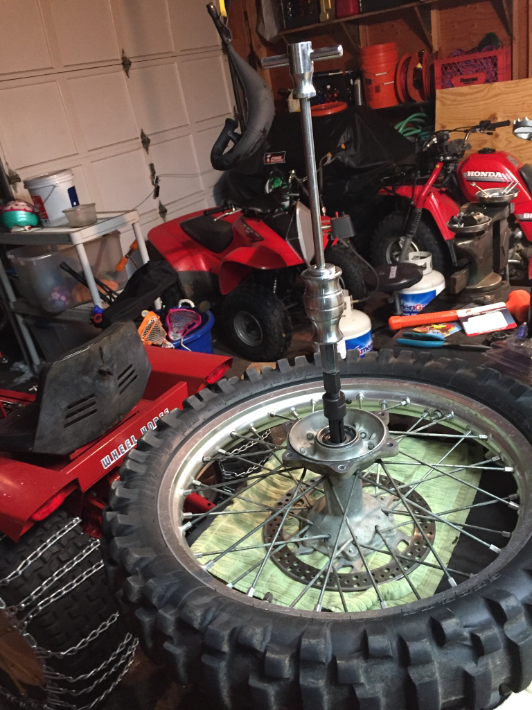

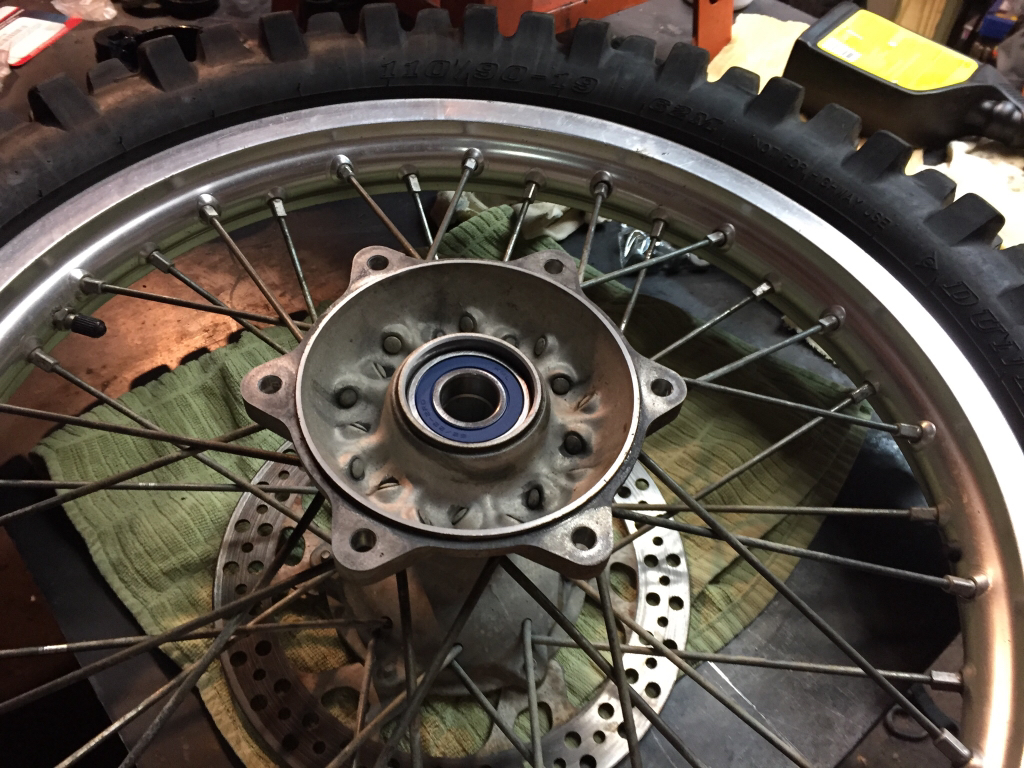

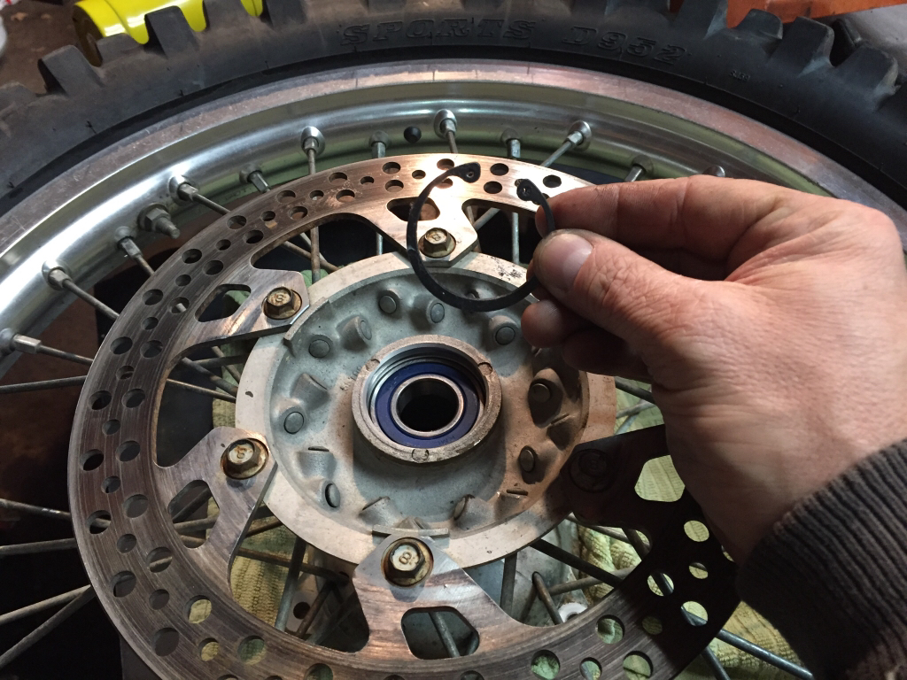

Next up was the rear wheel bearings. After I tightened up the spokes I closely investigated the bearings. I didn't notice any flat spots but they just didn't turn easily so I figured, what the hell.. Swap'em out. I used my blind bearing puller and MAPP gas torch. Bearings came out very, very easily. Before I started removing the bearings I put the new ALL BALLS bearings in the snow and let them chill until it was time to install.
When it came time to install I heated the hub with my torch again and ran outside, grabbed the bearings out of the snow, cut open the package and dropped them right in. I love when it happens like that. Oh the brake disc side has a ring clip that needs to be removed before you can get the bearing out.
Before
After

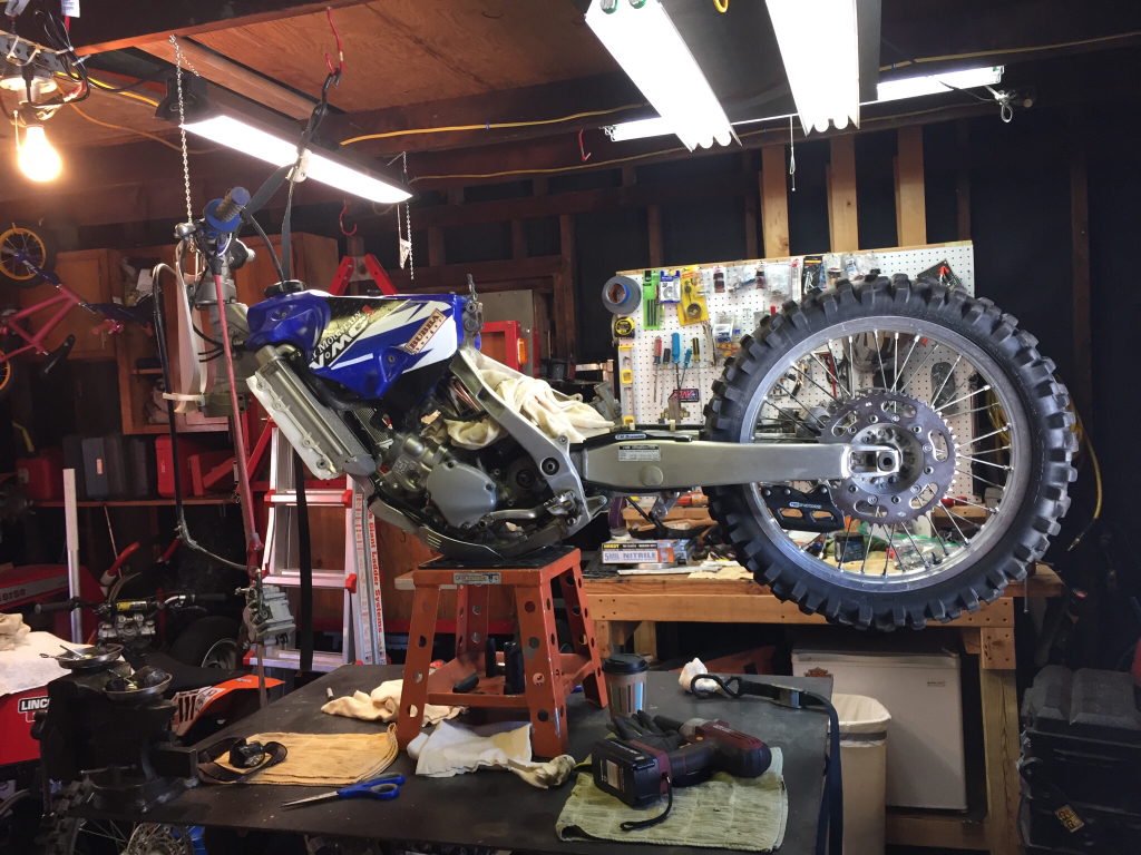

I think I would like one of the newer yz 125's. Carb mounting angle just says "ride me on my rear wheel", doesn't it?
Lol.... Yes... From these pics it does appear that way. That angle is a bit exaggerated though. I have the front suspension off so it is actually tipping forward more than it would if it was sitting properly on two wheels.... For a minute there it was reminding me of those older, smaller, horizontal Honda motors.

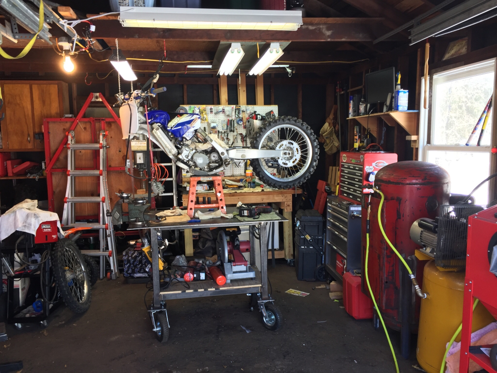

Yeah.... I needed a larger capacity to operate my sand blaster efficiently. I found that horizontal tank (tank only) really cheap on Craigslist. I welded 2" angle iron to the sides to make legs and stood it up. Obviously saves a lot space which is needed in my garage... The yellow compressor has the pump on it. I just connected them both together... [emoji1303]
That is similar to a set up I have. I have two large tanks I put under a shop trailer. I have a compressor on a gas engine that will fill it in time. I have about 200 gallons of air capacity. I use my truck compressor with it to get it up to 130 lbs quickly, valve the truck off and run the gas compressor. I can take an axle worth of wheels off either of my tandem axle trucks without the wrench slowing down. otherwise it is a 15 minute process to get the second side off.
I'm learning that one can never have enough compressed air...
