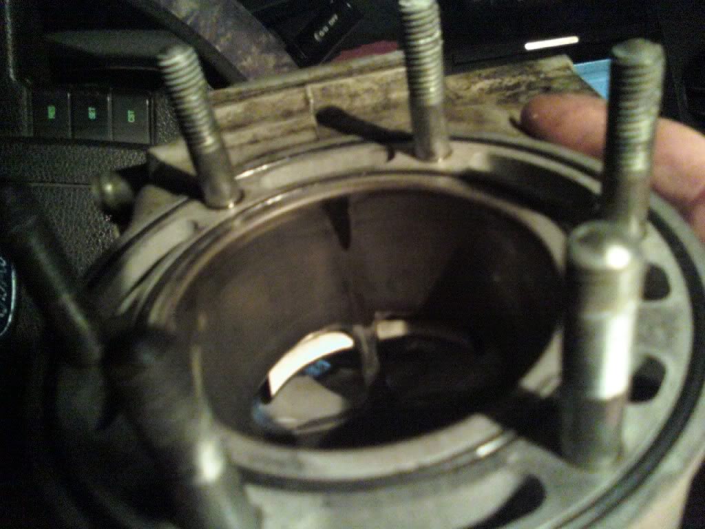

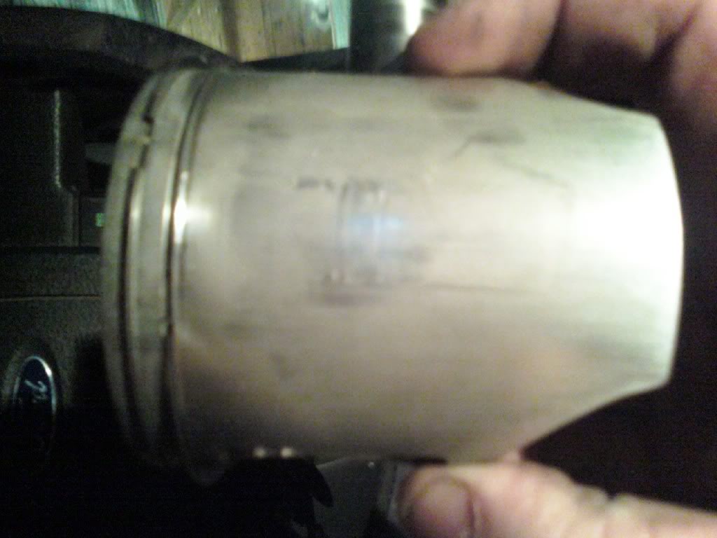

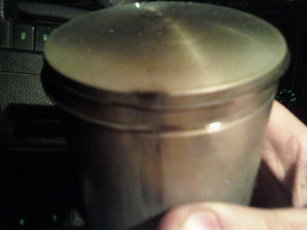

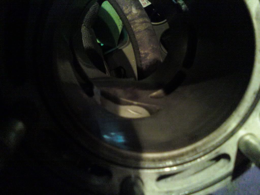

Either the rings are shot... or it needs to be replated... Only thing it comes down too...i think.... i dunno im just aggrivated with it right now...i sorta think i know what going on with the clutch issue... The shaft that goes down into the clutch cover is either broke... or whatever holds it inside the case is broke... the clutchs still pulled/drove the bike fine... i had to drive it home they didnt slip or anything like that...

Well. I told you!!!!!! That you may need to have the cylinder replated purely based on the age of you bike. Mihylo says powersealusa.com. I like www.Kustom-Kraft.com They did my cylinder plus all the required repairs after they removed existing nikasil. It wasnt cheap but cured my engine problems.

Do it now before its too late! just rering the piston and get another 40 hrs out of it.
