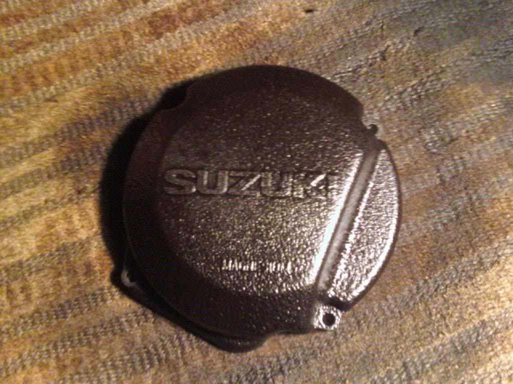

Coated my stator and clutch covor with undercoating... Lets see how long it last...
