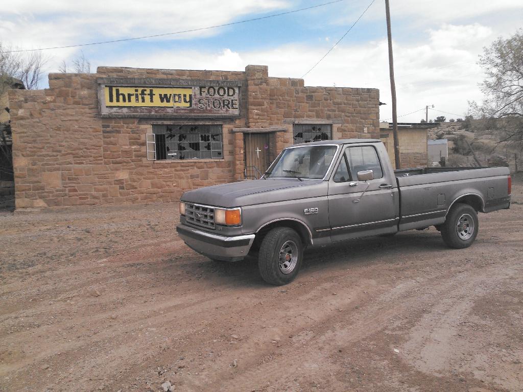

Drove it, found an old grocery store that's been abandoned for a long time, the surrounding community, consists of about 100 people max, there was a cross on the door as well as lots of flowers laid there, I wonder what happened here.
